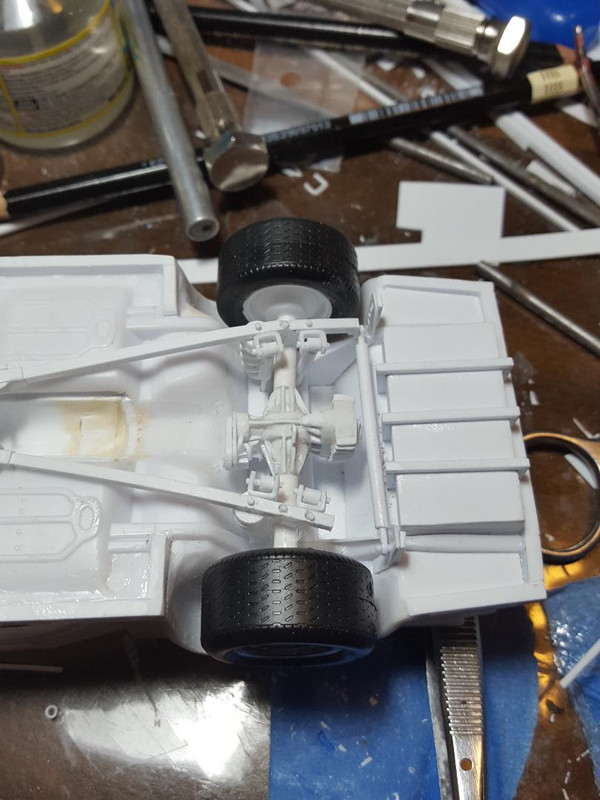

Got the track bar installed without glue so far, as well as the axel assembly itself just to make sure it will install properly. I will glue it in as an assembly after I get it painted and hopefully plumbed. Also want to install some chains on each truck arm that they used to limit travel of the axle.

Added two bars from the support for the truck arms to right in front of the rear wheel openings.

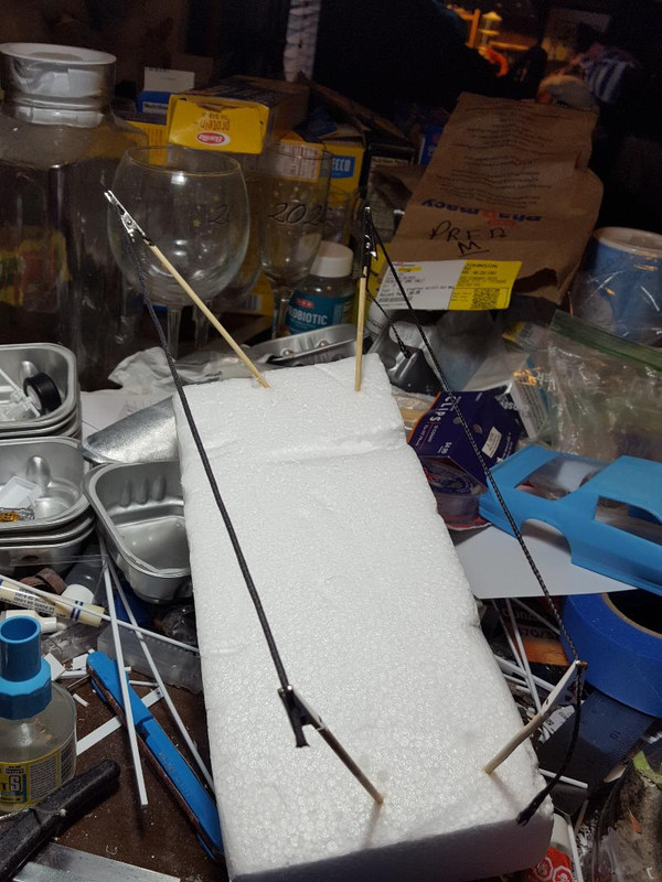

Had to paint some jewelry twine for hoses on the engine and to plumb from the fuel filter in the trunk to the engine and some jewelry bead cord for spark plug wires. I used Revell chrome to paint the twine and roughed up the bead cord with some 3200 polishing pad and then primed and painted it with a mix of Vallejo acrylic paint. I need light blue wires. Also finished and installed the fan to the engine.

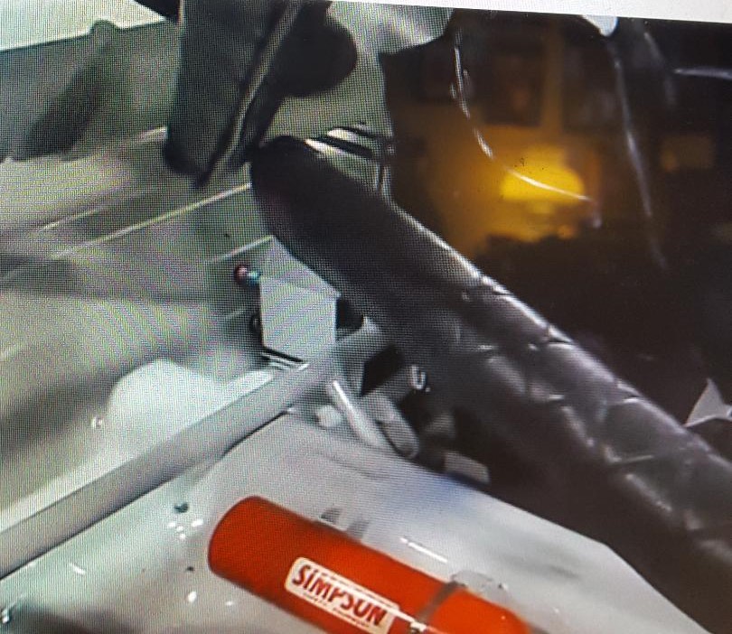

Thanks, Donato. I made the spark plug wire too thick and had to redo them at .5 mm. I made a battery box and need to make a differential cooler but have no good ref photos.  At least I will have one and nobody knows what it actually looks like but Ray Evernham. The seats is in the way of seeing the battery box so I will just have to guess.

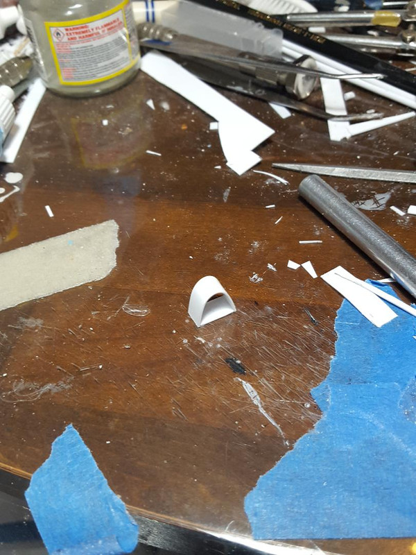

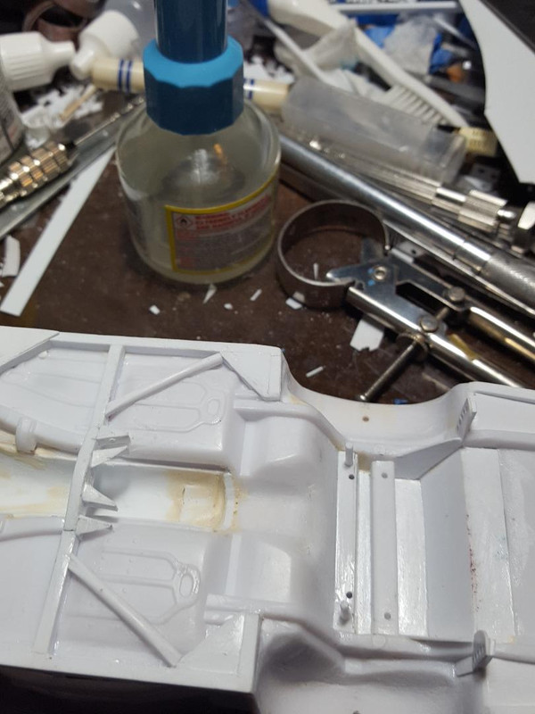

I had to fix the floor on the model underneath so there would be a place to put the exhaust screen for the differential cooler. I also started on the cooler.
Got the rear end cooler done and the screen under the car where the heat leaves.
