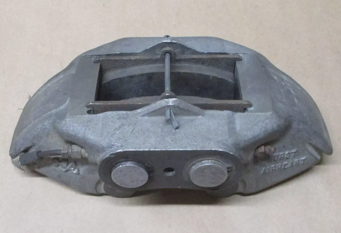

Started on the caliper. It's at its raw beginnings. Have to see if it's even feasible to make 4 of these things. Its going to have to be wider and then there may not be room for them.
Great job Mark. At this point, I'm kinda expecting this highly detailed piece to fire up and idle.
